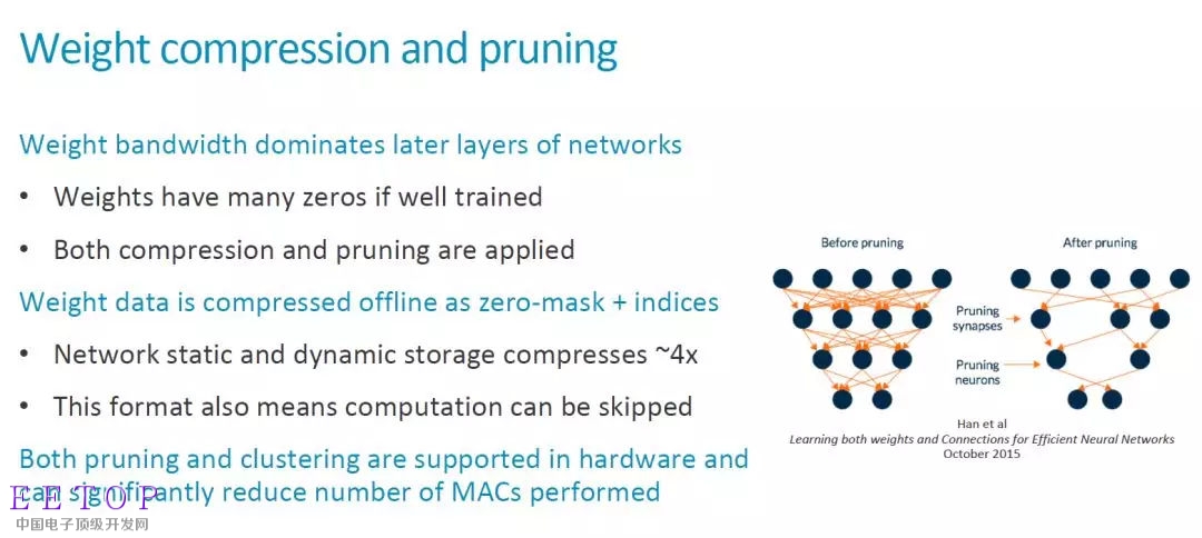

在这次发布中信息中,ARM还强调了他们在数据压缩方面的考虑,包括对lossless compression的硬件支持。这部分内容我在之前的文章中也有比较多的讨论,就不再赘述了,贴几张比较有意思的图,大家看看。

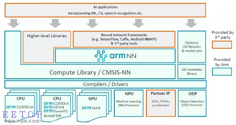

ARM的另一个重要优势是,ARM在推出MLP之前在软件工具上还是有一些准备的,包括armnn和开源的计算库等等,如下图。
这些工具的广泛使用都可以帮助ARM积累经验,优化硬件和软件工具。正如[1]中引用来自ARM的说法,“Winning the hearts and minds of software developers is increasingly key in getting design wins for hardware sockets...This is kind of the start of software 2.0. For a processor company, that is cool. But it will be a slow shift, there’s a lot of things to be worked out, and the software and hardware will move in steps.”
